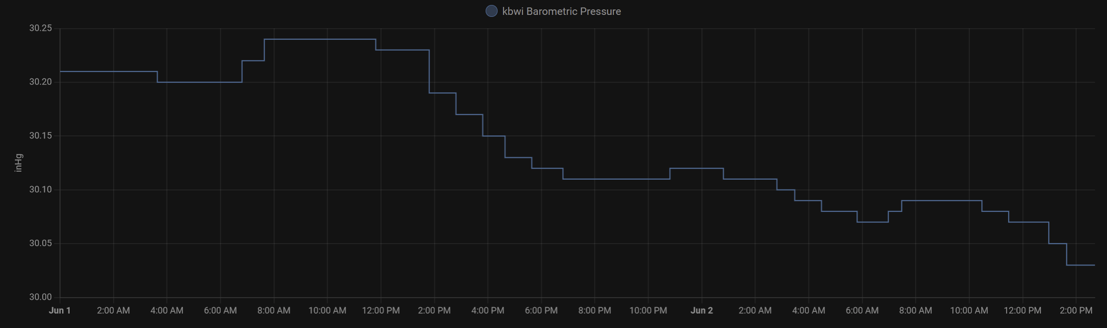

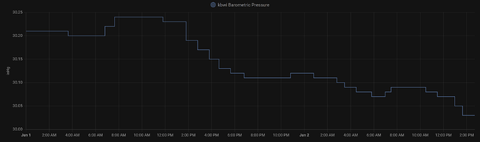

Moreover, my experience is the NWS rarely updates shortly after the hour. Take a close look at this:
I agree, my labels are inaccurate, meaning they’re not day0, day1, day2, etc. but then they are just labels and I treat them as such in my use of them - I could have easily called them anything such as forecast_0, forecast_1, and so on. It’s just the way I named them. As far as the frequency goes, it’s close enough, not using them for anything other than creating a morning weather briefing played on a speaker while I’m having breakfast. I used to scrape the forecast from the NWS website but found it wasn’t as reliable as I wanted - that’s still the way I get the announced label such as “Today” , “Tonight”, “Memorial Day”, “Tomorrow Night”, etc.
