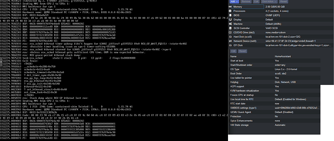

I get this error every 4 days or so and the system crash, have to stop and restart the HA proxmox VM.
This is the VM configuration and the last console log.
Anyone knows something about this.

Iβve spotted several things wrong. Itβd be easier to follow these instructions than explaining how to fix it.
https://community.home-assistant.io/t/installing-home-assistant-os-using-proxmox-7/201835/714
Give your machine specs. Hope youβre not using the Intel Celeron N5105 Processor.
Its a NUC with an Intel(R) Celeron(R) N5095 @ 2.00GHz
SSD: NGFF 2280 256GB
Memory: 8Gb
Basically the same as the N5105
https://cpu-benchmark.org/compare/intel-celeron-n5095/intel-celeron-n5105/
Thereβs know issues with those processors and Proxmox
https://forum.proxmox.com/threads/proxmox-vms-crashing-freezing-on-intel-n5105-cpu.113177/
Guess iβll run HA in docker then to test, because with my other applications i have no problem.
Updated to Kernel 5.19 looks like it fixed for some guys. Letβs see.
13 days running without a problem after updating the kernel.
