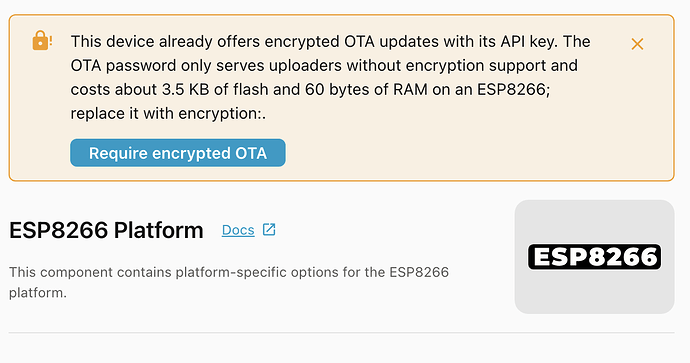

Hi all,
I have a few ESP devices running and keep seeing warnings regarding memory use etc when updating regarding the use of encryption.
I can’t figure out how to enable it without risking locking myself out of the device?
Can someone help with a little guidance please?

esphome:
  friendly_name: ESP Monitor 1
esp8266:
  board: esp01_1m
# Enable logging
logger:
# Enable Home Assistant API
api:
  encryption:
    key: "xxxxx"
ota:
  - platform: esphome
    password: "xxxxxx"
wifi:
  ssid: !secret wifi_ssid
  ap:
    ssid: "Esp-Monitor-1 Fallback Hotspot"
    password: "xxxxxx"
# DHT22 configuration
sensor:
  - platform: dht
    pin: GPIO14
    temperature:
      name: "Living Room Temperature"
      filters:
        - offset: -0.9
      accuracy_decimals: 2
    humidity:
      name: "Living Room Humidity"
    update_interval: 60s
# ESP8266 WiFi configuration
  - platform: wifi_signal
    name: "Living Room WiFi Signal"
# ESP8266 status configuration
binary_sensor:
  - platform: status
    name: "Living Room Status"
    update_interval: 30s
captive_portal:
You comment out the password in the ota: section and add encryption: following platform.
ota:
  - platform: esphome
    encryption:
#    password: "xxxxxx"
PS: I assume you are using version 2026.9.0 or higher.

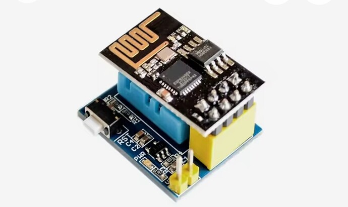

By any chance are you uing one these modules?
Sorry but no, i only have the basic ESP32 boards
Thanks for that, it really was that simple :slight_smile:
Your code says esp8266 not esp32.
Just checked, i have both running
