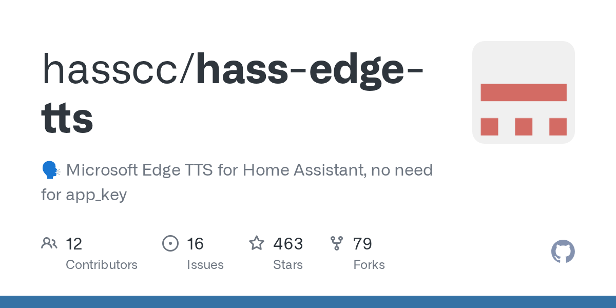

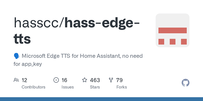

Have you tried other TTS services to rule out the problem with other components?
What are the alternatives? That are local and open source.
For testing, this is the most user-friendly option.
And if you’re familiar with Python, or at least containers, then GitHub is full of different implementations of wyoming servers for a variety of TTS.
