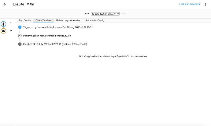

If I look at the trace for this automation it shows as triggered and the action performed but unfortunately it doesn’t work when used through the automation.

Thanks for the reply. Here’s the full trace:
