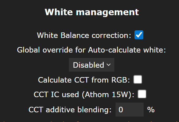

Does warm white work in WLED? If so, then make sure you don’t have any funky settings in WLED:

Also, my color screen has a separate control for color and white luminance separate from the global one the strip uses:
