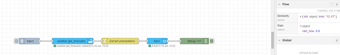

Assuming that you want to read the weather forecast in Node-RED, and then save it to Home Assistant (so you can access it in HA and also in Node-RED) the following flow might provide you with some ideas.
You will have to change the service call entity_id to your weather forecast, and you can play around with the names I have used in the sensor. The flow gets the weather, uses a bit of JSONata to build a new object with just the bits we want, and then a Sensor entity node to write the precipitation to the state value, and the precipitation probability to an attribute. You can, of course, have two sensor nodes, one for the rain and another for the probability if you wish.
I have also added a save of the ‘rain object’ to flow context. If you plan to use this in Node-RED only (and don’t need the values back in Home Assistant) then you can drop the Sensor node (and the configuration node behind it) completely, and just read back the flow context variable ‘Rain’.
Here is the basic flow
[{"id":"46067599524f8de5","type":"api-call-service","z":"7021f7d89ccb8403","name":"","server":"","version":5,"debugenabled":false,"domain":"weather","service":"get_forecasts","areaId":[],"deviceId":[],"entityId":["weather.forecast_home"],"data":"{\"type\": \"daily\"}","dataType":"jsonata","mergeContext":"","mustacheAltTags":false,"outputProperties":[{"property":"payload","propertyType":"msg","value":"","valueType":"results"}],"queue":"none","x":440,"y":2700,"wires":[["c14743f79f67a3de"]]},{"id":"c14743f79f67a3de","type":"change","z":"7021f7d89ccb8403","name":"Extract precipitation","rules":[{"t":"set","p":"payload","pt":"msg","to":"{\"rain_now\": (payload.**.precipitation)[0], \"rain_chance\": (payload.**.precipitation_probability)[1]}","tot":"jsonata"},{"t":"set","p":"Rain","pt":"flow","to":"payload","tot":"msg"}],"action":"","property":"","from":"","to":"","reg":false,"x":670,"y":2700,"wires":[["1f834b10f5498869"]]},{"id":"1f834b10f5498869","type":"ha-sensor","z":"7021f7d89ccb8403","name":"Rain","entityConfig":"1c295f2ff52050b6","version":0,"state":"payload.rain_now","stateType":"msg","attributes":[{"property":"chance","value":"payload.rain_chance","valueType":"msg"}],"inputOverride":"allow","outputProperties":[],"x":850,"y":2700,"wires":[["f2672103f97e8d6f"]],"server":""},{"id":"1c295f2ff52050b6","type":"ha-entity-config","server":"","deviceConfig":"","name":"SC Weather Rain","version":"6","entityType":"sensor","haConfig":[{"property":"name","value":"Weather Rain"},{"property":"icon","value":""},{"property":"entity_picture","value":""},{"property":"entity_category","value":""},{"property":"device_class","value":""},{"property":"unit_of_measurement","value":""},{"property":"state_class","value":""}],"resend":false,"debugEnabled":false}]

Hello Geoff
Thanks for you detailed reply to what was a poorly asked question!
While I did not fully understand your reply’s and go not get to work what you sent.
They did show me the way ahead and I have now fixed my problem.
It would seem I just needed to understand the “Change node” better which you have helped with.
