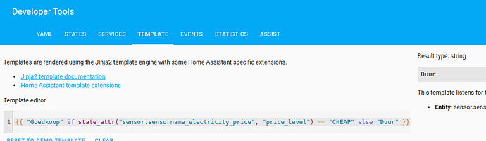

i created a template helper in which I have the following to retrieve the value of an attribute:
{{ state_attr(“sensor.sensorname_electricity_price”,“price_level”) }}
this works fine
now I want to add an IF statement to it to achieve the following:
if value = CHEAP then Goedkoop else Duur
what is the correct syntax for this?
or is there a better way to achieve this considering it’s a translation to local language that I am trying to achieve.

Developer Tools / Template is your playground, and the two links on that page (visible in my screenshot above) are the key reference documentation.
