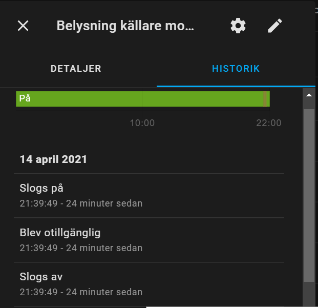

What happens?
The first time Tuya On/Off turned off when I lit Dimmable Light 8. But after that it has basically not worked. I’ve not managed to get it to turn on again when I turn off Dimmable Light 8.
The odd thing is, this is how it looks under info for my automation to turn off Tuya On/Off when I turn on Dimmable Light 8:
Its Swedish for “Turned off” then “Became unavailable” and then “Turned on” – all during the same second??
And what does it mean when this is stated in regards to the Automation?
The Trace Timeline for the automation says nothing and Tuya On/Off show no change.
Anyone have any idea what this could be about??
Does it matter if mode is “single” or like “restart”?
