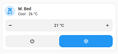

Yes, that is correct. Typically, with an air conditioner / climate entity which is what this turns into, it reports both the set point (i.e. the target/desired temperature) and also the current temperature.
With the above code, the “climate” entity will show the currently set temp (21) and the current temp in the room (26):
If you don’t want or don’t have a temperature monitor in that room, just comment the whole code block out and it will look like this (note the missing temperature entity on the top left)

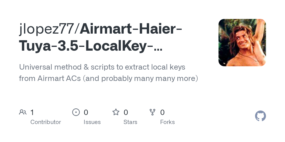

Hey! I’ve written a small guide to extract deviceId & LocalKey from the app, check if it works for Morris/TCL/Airmart… AC
