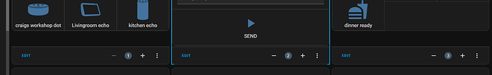

hey all i have been trying to set up my dashboard for some time now and have just installed layout-card which seems to work well but each card copies the height of the cards alongside it
bad image but as you can see of the 3 columns the middle has a lot of room below it and i was hoping i could push up the lone bottom middle card into the upper middle but the upper middle card is taking the whole space
i am just wondering if / how i could fit the cards to size, as the left and middle cards are bigger then the content of the cards itself, as they are copying the same size as the right
a closer example are these 3 cards
i would like the left and right to fit to the size of the content itself not just matching the middle which is the tallest one
any help is appreciated

yes that’s what i want the layout is fine there’s just obnoxiously large spaces because the card heights aren’t fitting to the content there fitting to the tallest in the row
this card uses up so much empty space below it i want the edit bar down at the bottom to be pulled up the the actual card size so i can fit other cards into this gap
how can i fit the borders to the size of the card so these spaces arent there
