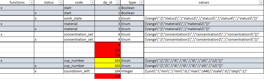

Hi @rfam13 , I’ve just bougth the same device, already configured on IoT tuya, but can you help me providing instruccions for add my device sensors and switchs/selectios on card like you?
There is some information on debug option on IoT, but how can add it? thanks!
Hi, on Iot Tuya (API Explorer → Device Control → Get Device Specification Attribute) i found more detailed information about de data points DP for this machine:

But some DPs are in both sections, so i’m not sure how to create:
For example, “dp_id”: 1, is a binary sensor? or switch? Besides there are some DPs that are not present on localtuya (red ones)
Thanks!
1 is the power switch so you can define as switch to control it. Everything else I’ve found is a sensor
