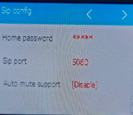

this is what I got in my phone - and at the screen of the doorbell.
The setup was ready when we moved and in the phone (1st image I scanned a qr code and connected.
With this data and setup do you think your addon will work?
