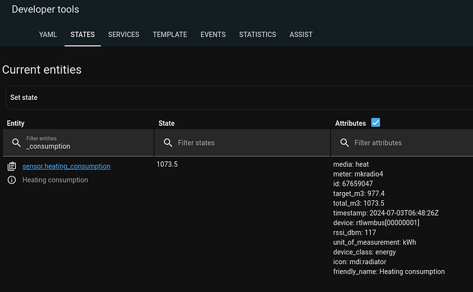

Maybe you can help me with integrating these “fhkvdataiii” thingies into HA.
I have successfully installed the wmbusmeters and getting the data into MQTT,
but I’m lost at the part on HA, where I have to add the sensor.
I only found this example:"

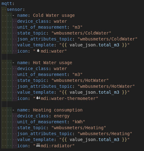

It’s the same :slight_smile: just change the device_class and the unit_of_measurement with something that is usable to you:
That gives me:
the state_topic is what you have configured in wmbusmeter:
I hope that helps
