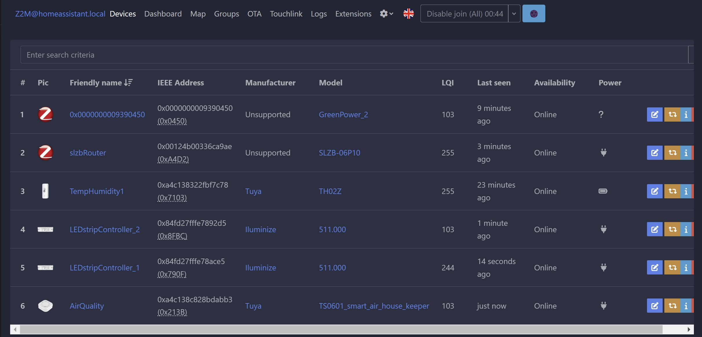

  1. The Moes ZGP switch is paired, but it is listed as unsupported in Zigbee2MQTT.

I have added a Philips Hue smart bulb but still the only payload I get from the 3gang switch is “last seen”
i got the same one … i think you never know with ali express :stuck_out_tongue: .
but i got it working with making an automatisation that looks at the MQTT channel of that device than you can debug in MQTT explorer .
for example i have a 2 gang switch ( sows up as unsupported but has “action” exposed ).
basic autimatisation : if MQTT “on” ( what button one sends) → toggel something
if MQTT ‘off’ ( what button 2 sends ) → toggel somethibng else
so have a look in MQTT explorere .
