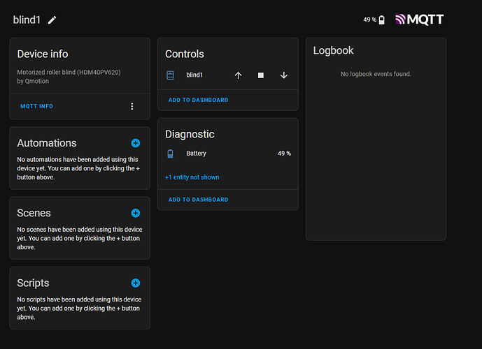

Yes to all of the above. I can see the blind in devices and entities which provide a up and down button which do nothing:

Try clicking on one of those states in the z2m gui. Or using the slider in the z2m gui.
I’ve tried that many times. Nothing happens. It seems from the z2m document that some extra steps are needed…just not sure I understand what they are.
