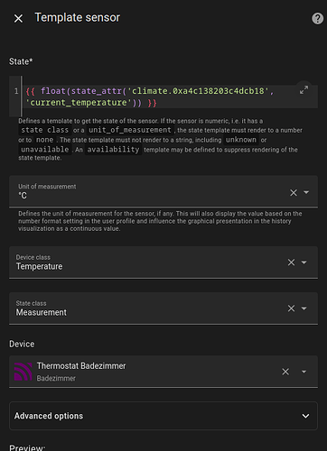

I have just integrated a Zigbee thermostat using Z2M. It shows up as a climate sensor and works fine, however it reports the temperature as an attribute which is not selectable in the area configuration.

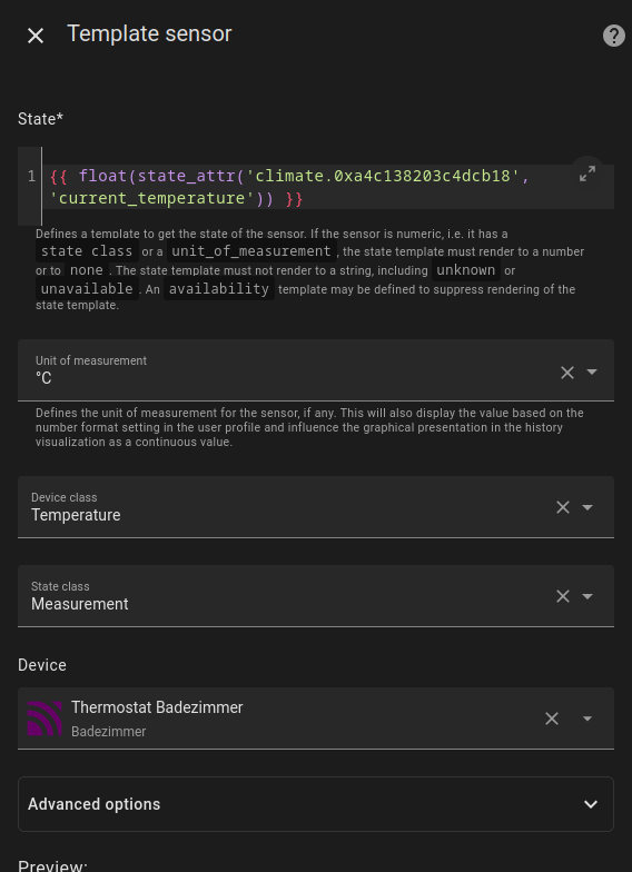

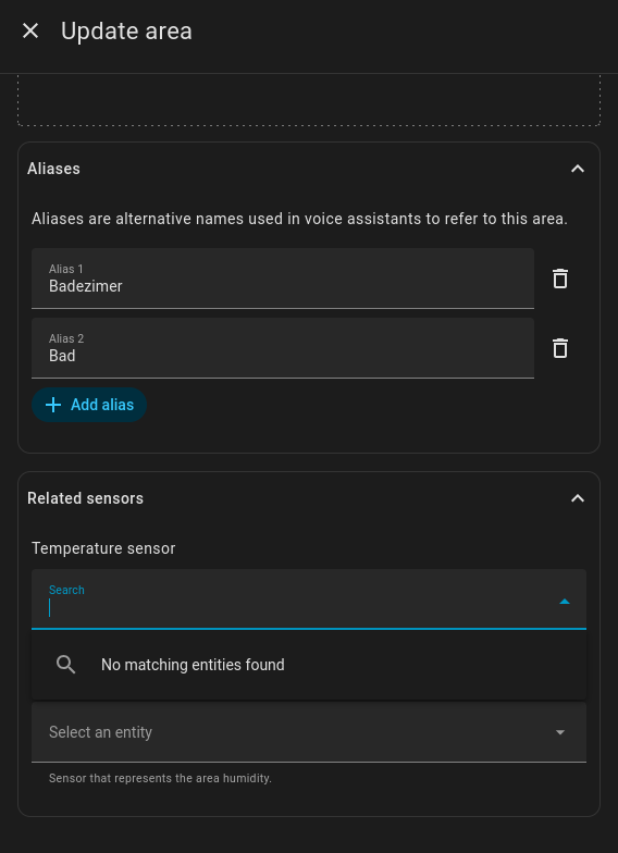

I created a helper entity with the respective template and assigned it to the area, but it still does not show up in the area configuration as a temperature sensor.
What am I missing here?

Same issue I have noticed. I have helpers template and max/min and none of them show up as pickable in the area config. I suspect - it will only show temperature sensors attached to a device.

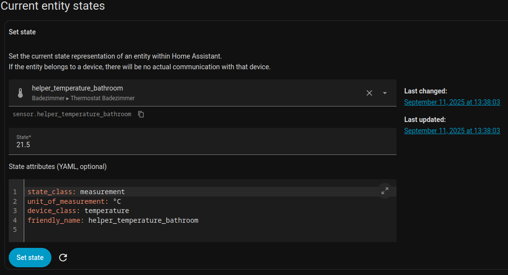

What do you see in Developer’s Tools, States?
sensor.average_garden_temperature
Helper - combine the state of several sensors.
state_class: measurement
unit_of_measurement: °C
icon: mdi:forest-outline
friendly_name: Average Garden Temperature
No device_class added to the sensor.
sensor.tmpl_outside_temeprature
This is a template sensor with the device_class added.
device_class: temperature
friendly_name: TMPL Outside Temperature
This DOES show up in the area config.

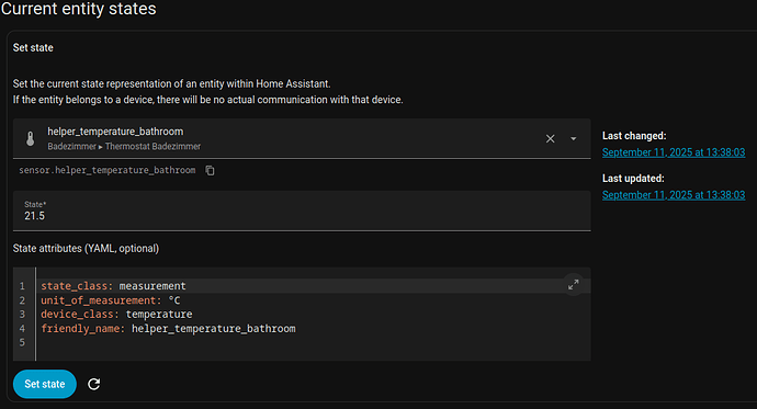

This is the helper, with device_class set, too.

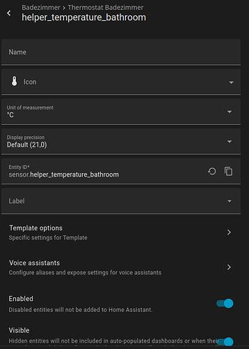

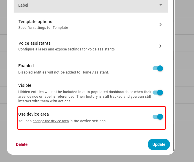

Scroll down, there’s a toggle that says “Use device area”. Untoggle this and you can assign the area.
Ooooh, thanks! That worked!
Just wondering, though: Why does the “Use device area” not work?
Use device area does work, what’s not working?
As you said, when “Use device area” is enabled, it’s not showing up in the Area configuration. Why?
It shows up under the device you attached it to in the area configuration. It won’t show up as an entity attached to that area in that window. That’s how that window has always worked.
Ooooh, interesting. I think I get it now, thank you very much!
