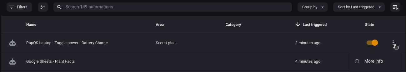

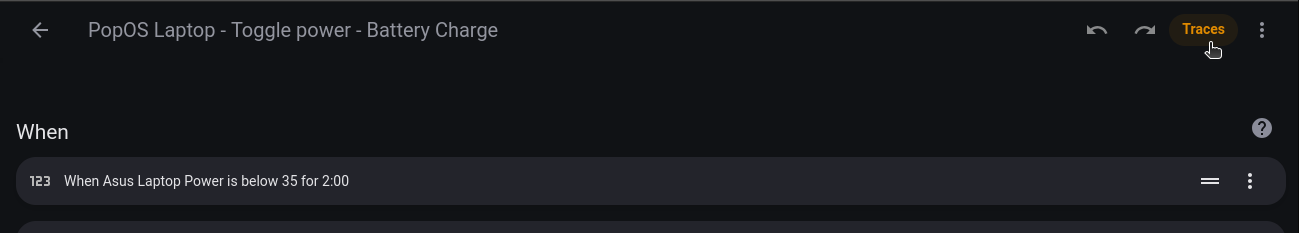

An automation’s debug trace is accessed through the Automation settings, either from the automations list by clicking the breadcrumbs to the right of the automation:
