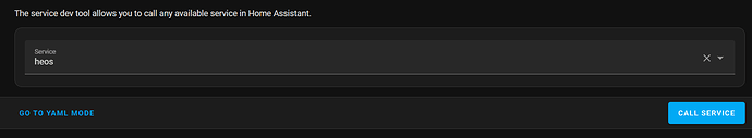

I am trying to connect my Home Assistant with my HEOS account. But unfortunately without success. I always get an error message in the Log that the service was not found.I have entered the data according to the documentation under services (see screenshot). I have entered the data according to the documentation under services (see screenshot).
Logger: homeassistant.helpers.script.websocket_api_script
Source: helpers/script.py:1310
First occurred: 18:27:00 (1 occurrences)
Last logged: 18:27:00
websocket_api script: Error executing script. Service not found for call_service at pos 1: Unable to find service heos.sign_in
Logger: homeassistant.components.websocket_api.http.connection
Source: components/websocket_api/connection.py:131
Integration: Home Assistant WebSocket API (documentation, issues)
[140600922435888] Error handling message: Unable to find service heos.sign_in
