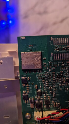

Hi guys not sure where exactly to start but here is what’s going on. I have an old Pill Minder buy Hero Health that I had purchased out right. However after I discontinued service and had paid 1,000 for the device I find out it is locked to their service. The device has WiFi etc. It appears to be running a Texas Instrument Chip though I can’t exactly make out the model. I had to peel off the Retailer Sticker to find that out. It has connections for an X & Z stepper motor, a T stepper motor, and door. It has a basic LED Display browsable by a hardware button. My question is can anyone guide me as to where I might be able to go for resources on A) How to hack it so that I can use it without their service or them connected to it. I am willing to JTag or whatever is required.
OR This is preferred
B) Modify it so it becomes an alcohol dispenser for mixing cocktails.
As I said I purchased the unit a couple years ago, at the time I didn’t realize they would keep it locked to their service.
Finally then integrate it into HA

It’s going to be hardware hacking. If you y’all wanna throw your hands in and help me I’m currently working on trying to hack it. The problem I’m running into is Arduino does not offer enough GPIO. Need to also get all of the U-shaped encoders working. I accident shorted a buck converter I think on the main motherboard. Since I’m no good at programming it’s not gonna be a software hack. Here’s what I’ve got done so far I can get the pill containers to move forward I can get the pill gripper or pill suction to move up and down in the whole entire pill arm to move backwards and forwards.
If you’re willing to help me Drop me a PM and I will reply with the Arduino sketch that I have so far ChatGPT is been a great help in writing most of the Arduino code.

Joining this thread and have the same issue/idea. i’ve got my used/unused H100 and wanted to convert it to use multiple esp32’s with canbus (or equiv) so i can overcome the GPIO issue you mentioned. I can’t see a way to DM you but i’d like to collab on this effort as it seems that with some work it is doable. my biggest obstacle is not knowing the sequence of operations as in rotate to desired location, turn on suction, lower arm, raise arm, move to drop location, etc. i see a vacuum valve and have no clue where that comes into play either but i assume it’s used to keep vacuum but stop the suction at the point of dropping the pills but since my unit is effectively bricked, i cant get it to go. while i’m willing to order a new unit and document this process, its a hassle to go through all of that so i figured id ask if you or anyone else has captured this process? also, any work you’ve done in identifying the wires/functionality as mentioned (moving it left/right, etc) would be a great jump start. thoughts?
