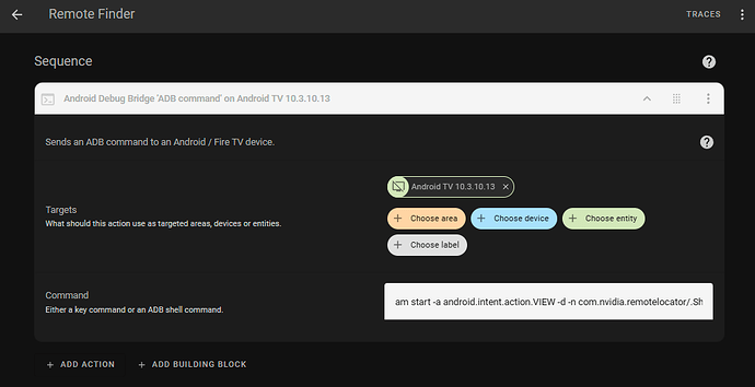

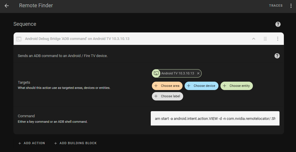

I followed the directions and had some errors but fixed them. Now I am able to run the command without errors but nothing happens. No error but my remote doesn’t make the sound.
UPDATE:
On entity ID I had to choose:
entity_id: media_player.android_tv_192_168_69_73
192_168_69_73 being my shield pro IP
I am up to date in Home Assistant and everything still works with both of my shields. I haven’t changed anything since what I posted above.
Addid in the GUI today and working great, thanks Alot!

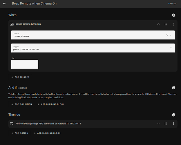

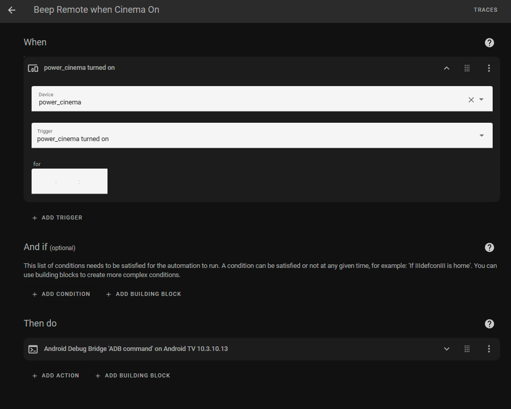

actually made it an automation when cinema power adapter goes on because the script wasnt saving, when i now say ok google start my cinema, the power plug goes on, nvidia shield with hdmi cec turn tv on, and remote rings
