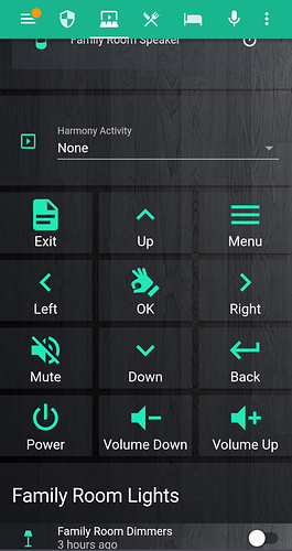

One area is my family room view. I created a “remote” grid via button cards and horizontal/vertical stacks.

Below is a screenshot from my phone
