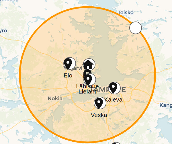

I have one big zone called “near area”, which is about 20 km radius from my home. There is also some smaller zones inside that area, like shopping centers.
I have some automations which are based on whether anyone is in home or “near home”. Example turn on the towel heater in the evening. Now the problem with this is, that if we are in the shopping center when automation is run, automation does not turn on the heater, because we are in the shopping center zone, not in the near area zone. Eventough these two zones do overlap.
I can circumvent this by checking all the zones in the automation. But this makes it really difficult to maintain. Everytime I add new zone inside the near area, I need to add it to multiple automations also. If I could add zone inside/under another zone, it would be automatically considered in all automations where I have added the parent zone.

There’s currently no support for multiple zones when reporting which zone the person is in. See this GitHub issue & the linked thread.
Your only option for now is to use the Proximity integration & have a single condition that you are less than 20km from home in the automation.
