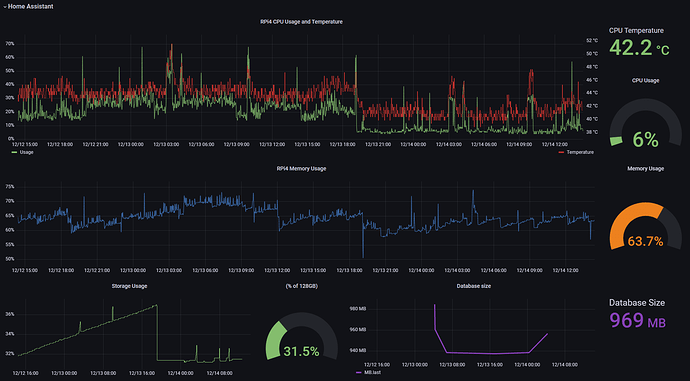

I am currently running HA 2022.12.3 on a RPi 4 2GB with SSD and I haven’t had any major issues I couldn’t resolve either on my own or by finding useful information in this community, for which I am very grateful. However, troubleshooting not so straightforward issues is what grinds my gears, especialy if it’s causing home automations to fail or have a noticable lag.
Ever since I upgrade to 2022.12.0 (currently running latest version 2022.12.3 as of writing this post), I have noticed an increase in CPU usage and overall lag in UI and automation response (light automation is most obvious).
Here is a snip of my RPi/HA usage stats over the past 7 days. It is clear when I installed 2022.12 - when average CPU usage went from 5% to 15-20% and when storage started to get filled linearly. I have set DB/log purging and storage usage was also constant until latest major version.
Can anyone help me troubleshoot what is causing this sudden increase in CPU and storage usage?

I had extremely high I/o on my pi after 2022.12.1 (skipped.0) I couldn’t find and rebooting seemed to have significantly improve. Hopefully the reboot helps the storage at least.
It’s not…, my CPU is now double what it was before the upgrade to core-2022.12
An update on the situation is due. I have found multiple issues with automations after upgrading to 2022.12, which caused HA log file to grow constantly (I had “logger” enabled).
First, I have disabled logger to stop log file from growing and CPU usage to drop, then I fixed all issues with automations (had to delete a few automations in yaml file, that were not visible in UI).
Everything is back to normal, it seems.
