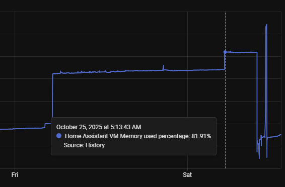

Home assistant itself shows high (cache) ram usage - screenshot from system monitor;
Which corresponds with what htop is saying, as well as to what proxmox is saying.

The ram usage stays like this until the server is restarted, and consecutive backups does cause the VM to run out of memory, which is currently every 3days (40% jump on each backup)
