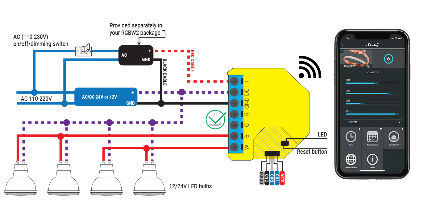

Connected to each are 5meter white LEDS 24V 50W each
Used the shelly RGBW2 to control them. The problem is a high pitch noise coming from the LPVs. Any soution for this? Maybe some dampening material or even opening them and filling with something?
