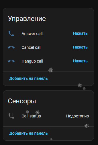

Hello. I installed Hik-Connect about a year ago. It detected my two Hikvision DS-KB8112-IM call panels. I set up automation using the Call Status sensor. I was happy with it. But in October, the sensor became unavailable. I didn’t update the firmware on the panels, nor did the app on my smartphone. Could you help me fix this?

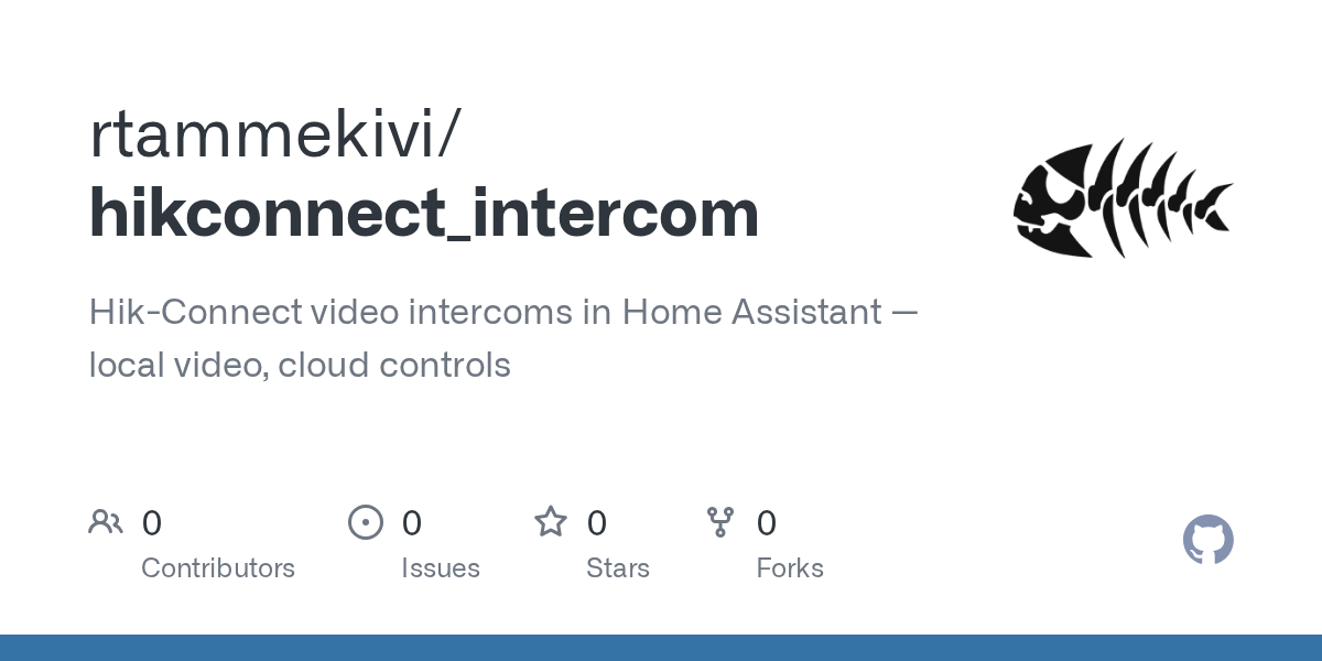

Hi! I took a whack at it with Opus 4.8. Probably bunch of bugs still, but features I use are now working on my intercom, including door cameras.
Feel free to test, PRs welcome for new devices.
Nice job! Usefull for lots a users… But isn’t it better to use official API? So also official camera integration from cloud? It’s a free API…
