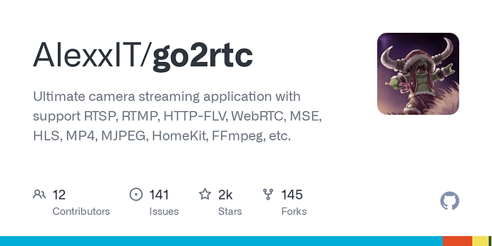

Hi, port 80 is indeed closed for ISAPI, but go2rtc addon also supports two way audio with RTSP backchannel, try that ?
try this tool: GitHub - AlexxIT/rtsplog
check in log if you see this below, if you see it, it should work using RTSP backchannel
a=recvonly
Or maybe your doorstation supports Onvif T protocol? should also work with go2rtcn, i see port 8000 open, i think thats onvif, but you need the T profile, you can check that with a tool called “onvif manager”
