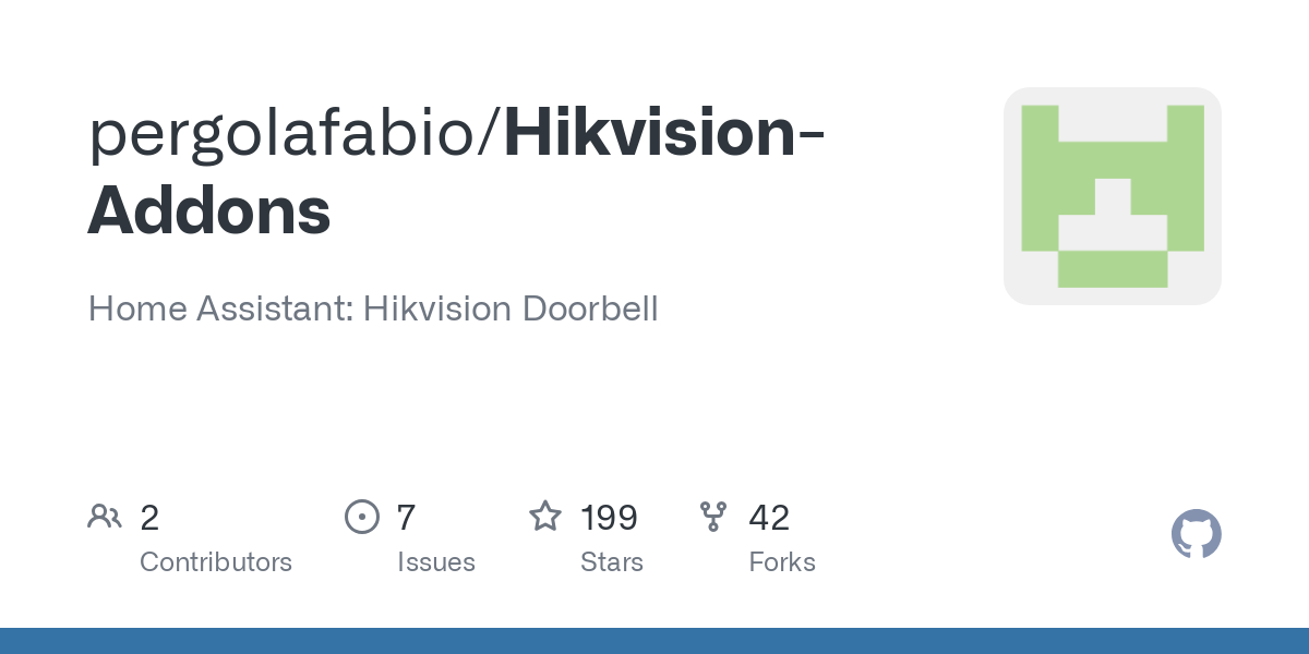

Here is the Add-on:
The addon can also run as STANDALONE DOCKER for users that don't use the add-on store
Confirmed devices : DS-KV8413, KD8003 and DS-KV8113 KV8213 DS-KV6113 and others…
