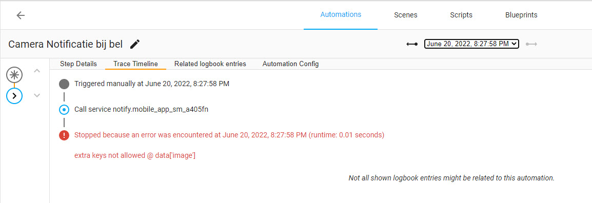

My knowledge of scripting is nil but with the information I could find I create a simple automation script at first with the GUI for creating scripts and then added the link for my image path manually, unfortunately without any result.
What am I missing or what am I doing wrong.

- service: notify.mobile_app_sm_a405fn
image: http://192.168.1.201/ISAPI/Streaming/channels/101/picture/?auth=

Perfect, thanx for pointing me in the right direction, I think I’m half way there now
After reading the Instruction manual “Camera” I modified the Automation script with the path to my tmp folder.
After triggering the Doorbell a snapshot was created in this folder with a time stamp.
Next I also added the Service notify.gmail which lead after triggering to an E-mail with attachment.
As you can see in the script I’m using a fixed name for my camera Snapshot and not the file with a timestamp because I don’t know how script this in an automation.
For now I think it’s no problem because by overwriting the same file it keeps my /tmp folder clean and if everything works well I always have copy in my mailbox.
