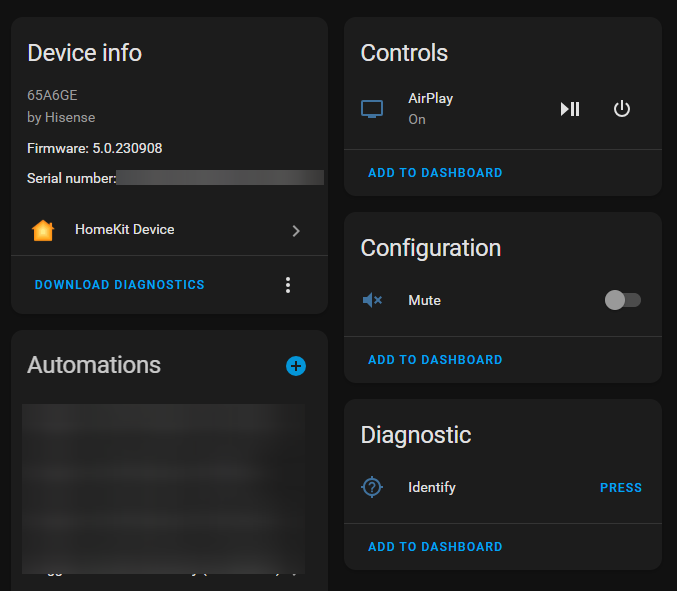

Is anyone working on a Hisense VIDAA integration? Specifically the latest VIDAA U7.
The DLNA/HomeKit integrations are possible for the most basic features but missing things like power on/off and remote control.

Hi, I could not get this to work. Any instructions on how to get this working with Homekit?
I only need discrete Power and HDMI inputs
