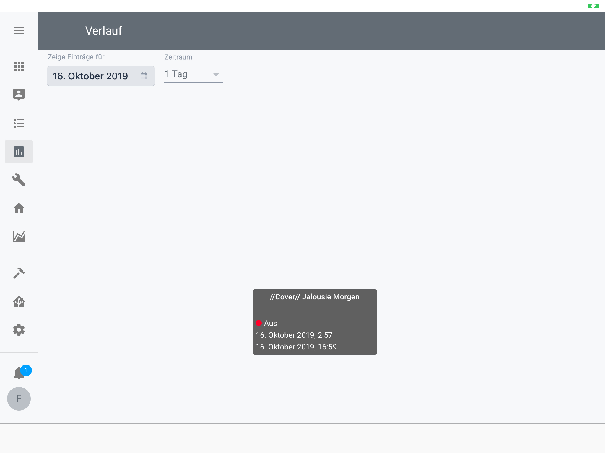

Hmm, maybe something to do with my compact custom header then… I was suspecting simply too much information in the graphs as I have a couple new ones that are very busy due to frequent disconnection issues. But it’s interestingly only the graphs with only one axis, all the ones with 2 axes work fine… And then today they all started working again fine… So I suspect something related to the content also.
Sadly I found Safari on both iOS and MacOS havin lots of problems with displaying the content. It is not handling resources properly and can easily be overloaded (do you see on Mac bar at the top of the screen with message stating that web page is causing problmes due to excessive resource usage and that restart can help?). I have some problems also with displaying new calendar selector (not showing at all until clisked somewhere) in history view (0.103+), being very slow while displaying States page (loooots of entities), page being randomly reloaded, especially when in Lovelace editing mode for complex cards… No such problems at all in Chrome.
Did someone ever solve this? I have the same issue on my iPad and iPhone in the browser as well as in the app, in Safari as well as in Chrome. Only on my Macbook it works
