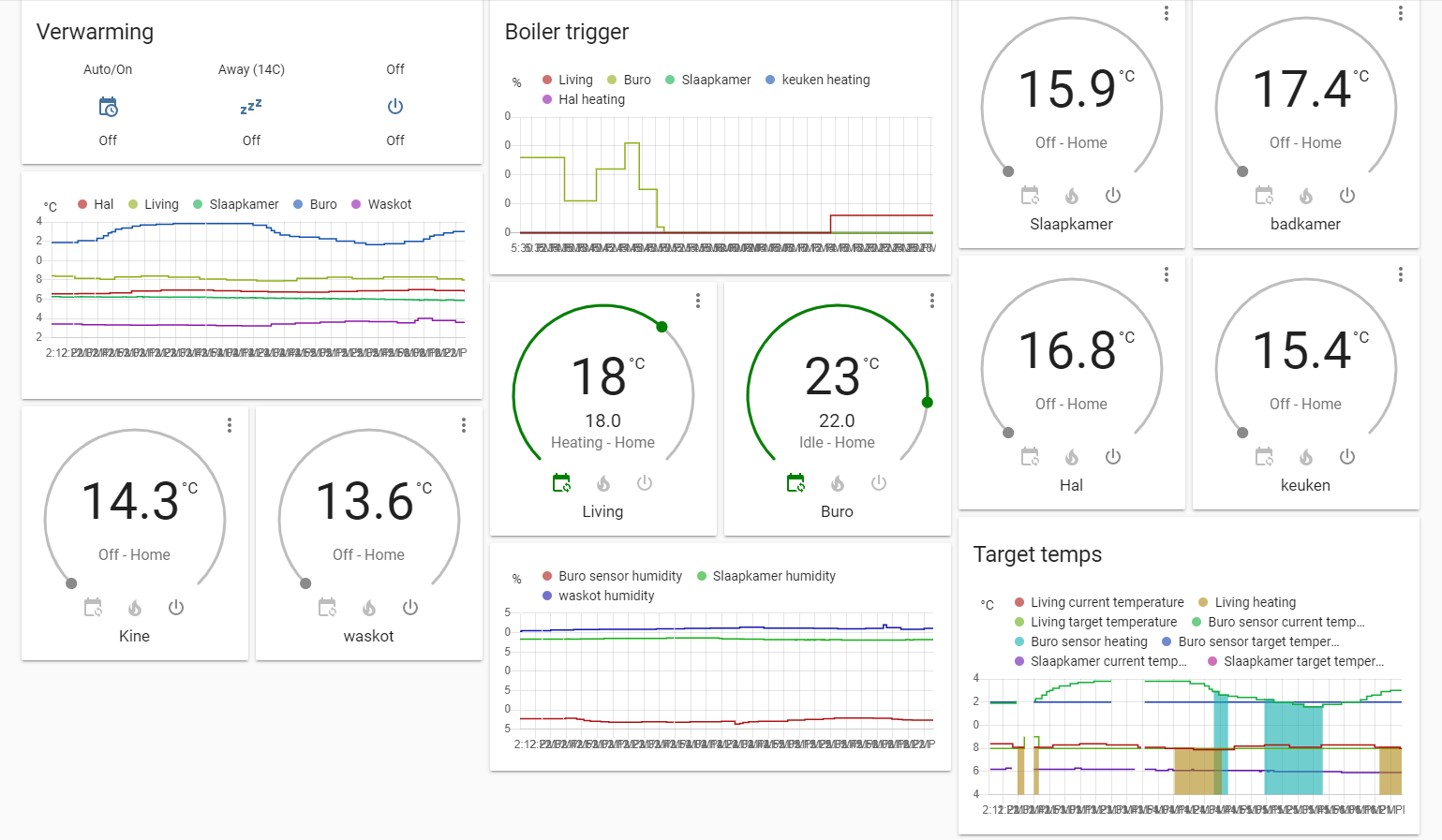

I already deleted the database twice:
I have a few hours worth of data now, but even setting the range to 1 hour the axis are wrong and lines are missing. Will this sort itself after 24 hrs or what ?

This is weird. When I connect via hassio.local, it renders fine. When I connect via IP address, I get the above mess. I tried clearing out browser cache, tried private browsing tab, makes no difference.

I am using brave browser however, but that uses chromium rendering engine and it used to work fine. Ill play around a little with disabling brave addons see if that helps.
Yep, it is brave browser. Its the shield setting that blocks “cross device recognition attempts”. Whatever that means, it messes up the history charts.
