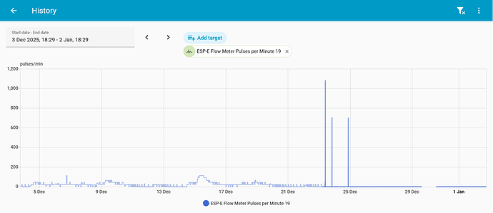

'History' now shows 'Long Term Storage' prior to 23rd Dec
I setup my HA about 18 months ago, and when I viewed ‘History’ I could see historic data all the way back to the beginning.
Checked today (2nd Jan) and now see data prior to 23rd Dec 2025 as ‘Long Term Storage’.
I haven’t intentionally changed anything related to storage, so what has happened ?.
( System is running on an RPi 4, with 44Gb of free space. )

‘Long Term Stats’ seem to be averaged or aggregated into 1 hour periods. My pump monitor generates between 800 and 1000 pulses over a two minute period. This occurs between 40 minutes and a few hours, depending on rainfall.
I could see the 2-minute ‘spikes’ going back for months. Now they are just blurred averages.

I know you all think I’m mistaken, but I can see the difference between the display of the two types of storage, and I know what I was looking at was historic.
