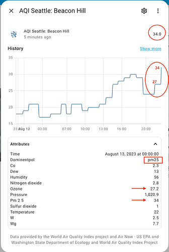

As you can see, the sensor reports a value of 27, which is the count of whatever the current dominant pollutant is. In this case, it’s ozone.
When the sensor updated for the next hour, the dominant pollutant was pm2.5, with a value of 34. But because the sensor’s historical tracking only considers its primary value – regardless of the dominant pollutant it’s from, which may change multiple times per day – its historical data are unreliable:

Results:
Even though I’m casting these values to int
, they still seem to be stored as strings. Hence, I can’t get the pretty graph of historical pm2.5 counts that I really want.
Where am I going wrong? Can I simplify this?
