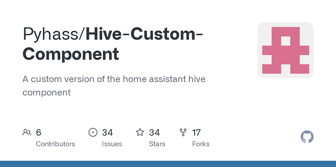

This is the custom component (using HACS) I’m using that got updated which fixes the issue for me:
A custom version of the home assistant hive component
It only showed to update after I updated Home Assistant to the latest (might be coincidence or the restarted polled for fresh updates in HACS).
