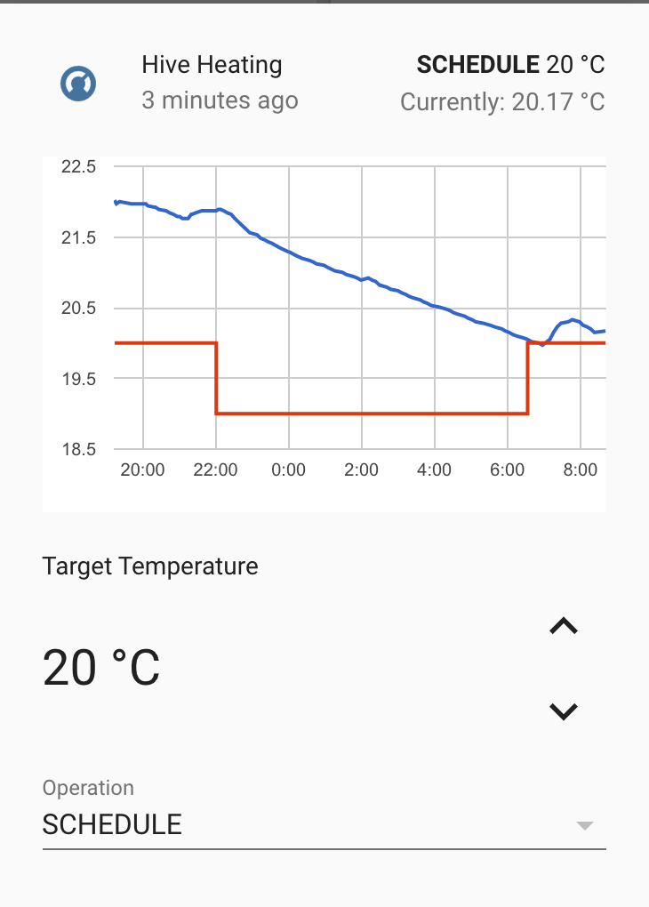

If I add it as a sensor then I get all the nice readings from each component and it tracks them very well :
but when I do this then there is only information in the Hive Heating device and no control:
if I add it as climate then none of the information comes through :
but I do get a little more on the Hive Heating device, but still no control:
Is it possible to have one component that is able to add devices for sensors to display and track the various modes / states / temperatures and also add devices for climate to control heating and hotwater?
Is anyone able to help me see where I am going wrong?

It contains sensors and a climate device for the thermostat and I have not worked out yet if you can have those in one file so they all integrate in to component, so at the moment if you would like the sensors then copy the file to “/custom_components/sensor” if you would like the thermostat copy to “/custom_components/climate” (you can do both)
the file will also need to be rename to “hiveheating.py”
you will then need to add to your configuration file for the thermostat :

Cameron, out of interest, how is the temperature selection displayed for my hiveheating component on your Home Assistant installation?
On my HA installation hiveheating temperature selection is an up arrow and down arrow, but in the screenshots in the post where GreenTurtwig shows hit hiveheat component the temperature selection is displayed as a blue slider
No your ok there are Up/Down arrows.

thanks Cameron, its good that ours are constant, I have no idea how you get target temperature on the blue slider (I have seen only humidity with a blue slider).

I decided to just go ahead and add HotWater control as a climate device, it works well but the presentation is not so good :
Does anyone know of a better component / device type other than climate that could present just a three state selection and display current operation (schedule / on / off) as above and maybe instead of current temperature the current state (hotwater on / off)?
