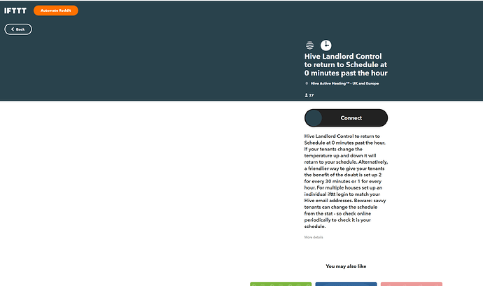

I was using IFTTT with Hive Heating to force it to revert back to schedule every hour. My question is how can I achieve this with Home Assistant? Hive no longer supports IFTTT so I need to find a way to do this in Home Assistant I would apricate some help with this.
Hive Landlord Control to return to Schedule at 0 minutes past the hour. If your tenants change the temperature up and down it will return to your schedule. Alternatively, a friendlier way to give your tenants the benefit of the doubt is set up 2 for every 30 minutes or 1 for every hour.
