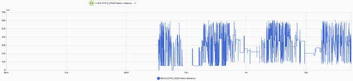

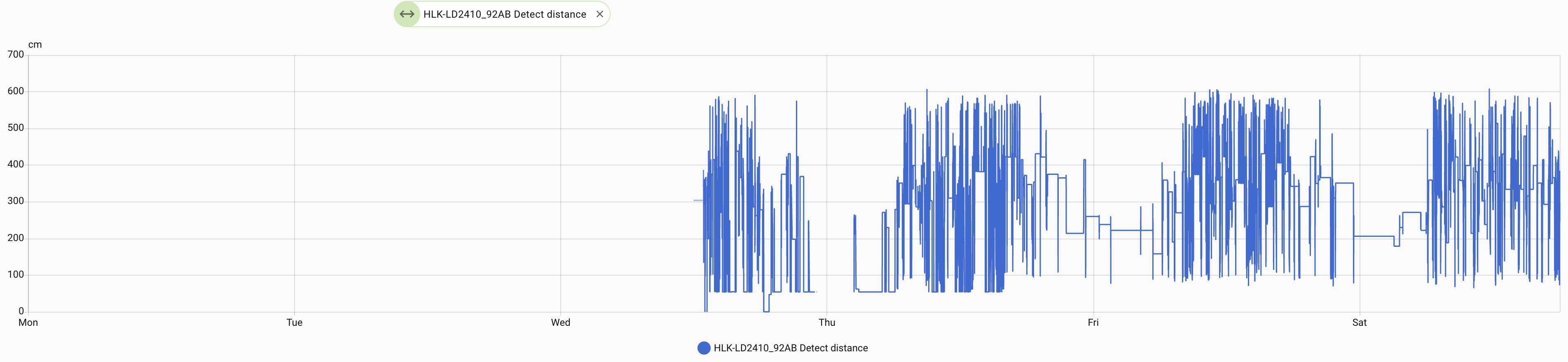

I’ve been running one of my LD2410’s over BLE (previously connected to an ESP32 running ESPHome) for a couple of days now, and it seems to work fine.
I’m using this integration for it, not the built-in one.
Since my HA server doesn’t support BLE I use ESPHome proxies, I think the nearest one for this sensor is about 6m away from it.
