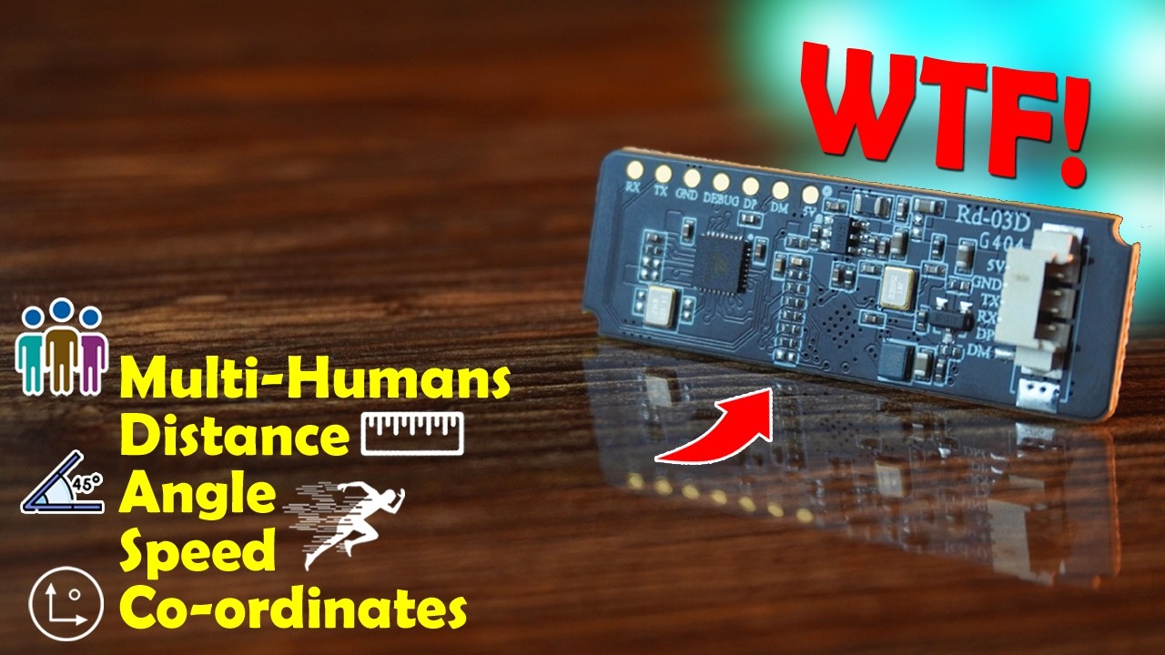

Is there an esphome component for the rd-03d?
I was watching the same videos, any idea what is the difference between RD-03D and RD-03E?
The E seems like ld2410 with gesture recognition.

I guess it is the same.
Do you mind sharing how you got it to work with esphome? I should get it sometime next week
Sorry I am doing packet parsing in C++ or JS, never used RD-03 with esphome, But I guess LD2450 component should work out of box, as my C++ parsing is exactly the same for both, with less config options for RD-03.
