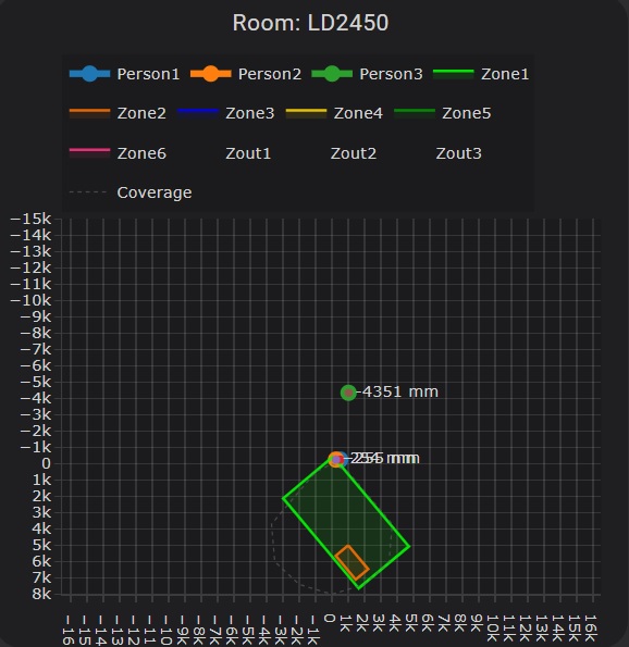

I am receiving fluctuating data. For example, Target 1 y constantly fluctuates from 243 mm to -28.123 mm and then back to 1022 mm. The same thing happens with Target 1 speed, which goes from -2.00 ms to 302 ms, for example.
On the map, I occasionally see a zone light up or target 1 around 0 mm, which is the location of the sensor.
In the HLink app, I do see 1 or 2 targets in the space as expected.
What could be causing this?
If i set the axis below zero i can see person 1 (sensor?) and person 2 and 3…
I also noticed this. The Apollo R PRO-1 uses the LD2450 and they mount it “upside down” if this manual is to believed. Thinking of flipping all of mine over and seeing if it otherwise affects usability.

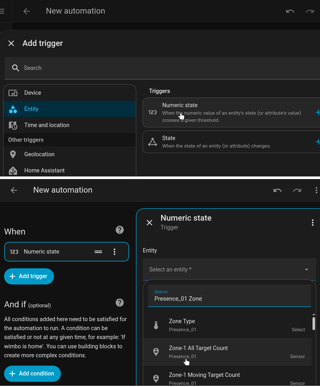

I have been messing around with a couple of the LD2450 sensors for the better part of a week now. The issue that I am having is with ZONEs. I have flash a probably 5 or 6 different yamls none of which give me the desired result. Which is occupancy of zones. The latest yaml that I tried is straight off the esphome webpage. I can setup zone in the HLK Radar Tool app on my phone. Those numbers are being transferred over into HA. However my big issue is that when I go to setup an automation. Can setup an automation for presence detection but NOT in any particular zone. Is there an easy way to resolve this? My yaml is below.

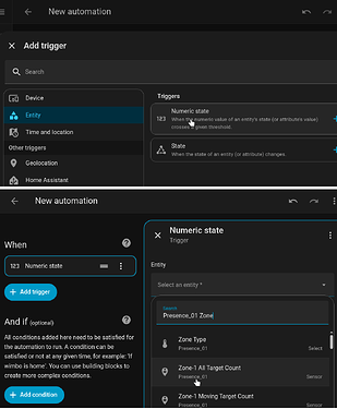

Hi, you need to do that via entity > numeric_state; you can’t select the zones through the device.

I hope that helps.
Sort of but where do I add entities. I am assuming I need to go into the HA config?
No, if you took the ESPHome YAML from the official ESPHome docs, your device already has the entities. You just need to select them in your automations via Entity, not Device.
The name of the device is the name you defined in ESPHome.
