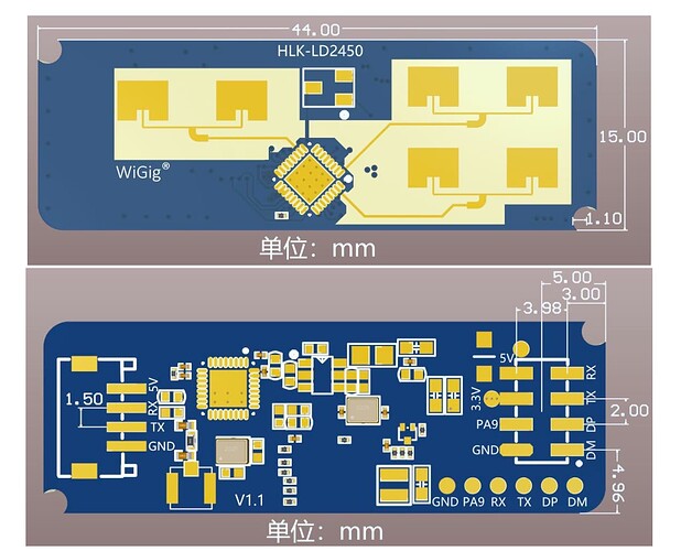

It is a 1.5mm 4pin connector.

The 2450 has two sets of interfaces, the simplest of which is for the ZH1.5, and the other, more complex (lots of pins, some of which are obviously intended for customized functionality). are of a different specification.
Generally speaking, ZH1.5 is the best for DIY connections.
We can be relatively sure of this because weâve used over 600 of them.
