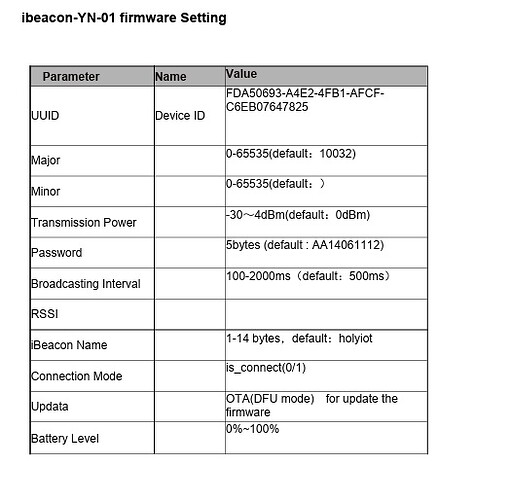

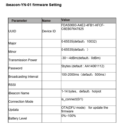

Screenshot 2025-01-24 at 16.00.32
How did you get the password?
Password 5bytes(default:AA14061112)
