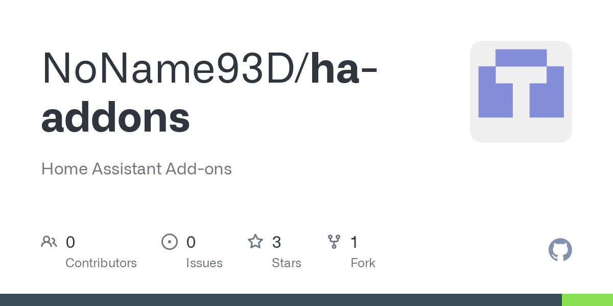

Forked it and updated to 20.0.0.0
Works at my installation with instructions mentioned in README.
Feel free to try - at your own risk. Be sure to make a backup beforehand!
I would also keep the old version, after all it is jonah1024’s project.
