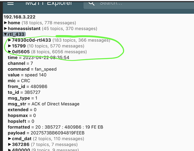

I can see a populated topic in MQTT Explorer but can’t seem to get that communicating to HA.
I am running a Mac w the rtl_sdr connected - this device is receiving info from a few environment devices and some home things.
the Mac is also publishing this data to MQTT
from the Mac terminal - when mqtt is not enabled (shows the info being received from the usb)
then I run the command in Mac terminal to publish to mqtt -
I can see this via mqtt explorer
however - when I go to HA - im not seeing this.

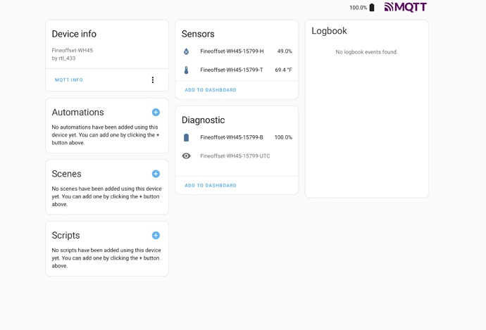

I put the screen shot above referencing how HA is missing some of the data reported by one of my sensors - and how that sensor is correctly capturing data as per mqtt explorer…
in the rtl_433 mqtt auto discovery add on that I am using - here’s is what I see in the logs…
DEBUG:paho.mqtt.client:Sending PUBLISH (d0, q0, r1, m140), ‘b’homeassistant/sensor/Fineoffset-WH45-15799/Fineoffset-WH45-15799-H/config’’, … (422 bytes)
INFO:root:Published Fineoffset-WH45/15799: time, battery_ok, temperature_C, humidity
INFO:root:Skipped Fineoffset-WH45/15799: pm2_5_ug_m3, pm10_ug_m3, co2_ppm, ext_power
where the skipped parts are what im looking for
