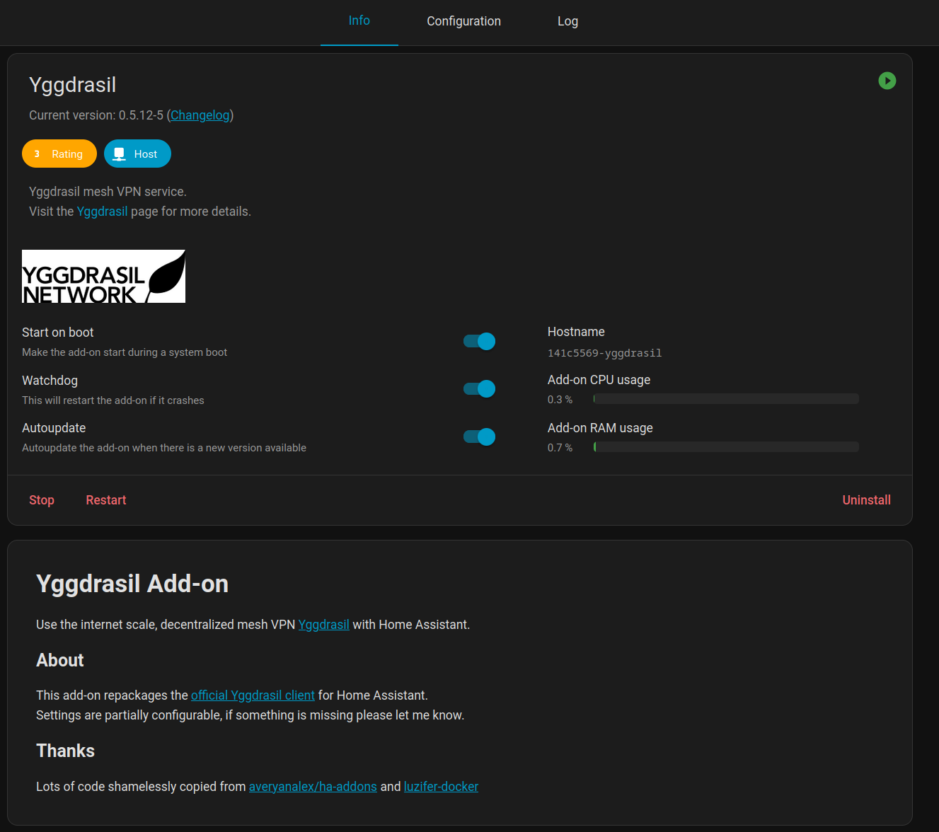

Hi, first post here to share an addon I made.
This is an addon to run Yggdrasil on Home Assistant. I’ve been using a local build version for a while and yesterday I decided to polish it with pre-built images and to share it with you.
Repository URL: exu/hassio-addons - Forgejo: Beyond coding. We Forge.
Yggdrasil
Available for: x86_64, aarch64
It’s currently missing specific documentation. Have a look at the official Yggdrasil Config Reference (link pending due to new user status) to learn how it works.
Every option except “peers” is optional. You need peers to establish a connection to the/a wider network. You can use a few public peers (link pending due to new user status) to join the official Yggdrasil network.
Updated to Yggdrasil 0.5.13
