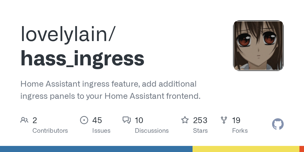

Like Nick says, don’t just open ports to the outside. You could deploy a reverse proxy like nginx and make it more secure that way.
have a look at this:

I also run a nginx app-in on my HA install and are using the 443 port to my HA setup from outside my home
Cant seems to see that this should do to help.
Also after install and the config copy/past part and a reboot later it just post and error in my logs about it cant set it up
