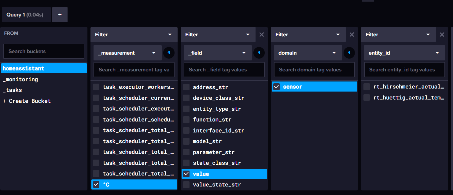

I have configured Home Assistant to use an influxdb2 on a virtual seperate server togther with grafana. HA is writing some sensor data to the influxdb, but only for 2 entities of the measurment °C, not for all of them. can’t find my fault in the configuration.

As already mentioned I can see data in the influxdb2 explorer, but not for all entities:

Especially I want to visualize the temperatures of the climate entities, so I added:
include
    domains:
       - climate
in the configuration.yaml because I didn’t see temperatures for the climate entities. but as of now I don’t see any climate entries in the influxdb2.
In HA I have several room thermostats from Homemaitc IP local integration, but only two are shown in the dev tools as sensors, can anyone explain why ? should I activate the entities ?
Found the data under “state” entry in influxdb, there are all my climates now. But still curious where my room thermostats are.
