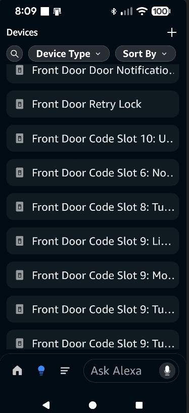

I’ve been battling Alexa issues since I began using Home Assistant about 6 weeks ago. I now have many devices in Alexa on my Android phone that if I tap, it does not access the device settings, it just returns to the main screen. I have numerous devices that when I try to use Alexa it tells me the device must be turned on. Or some other error. Now I just paired a Kwikset 888 door lock with HA. Unbeknownst to me it was added to Alexa and now I have about 200 entities for this lock in my Alexa devices! You can see some of them in the screenshot.
I can find no way whatsoever to delete devices from the Alexa app, which is a real pain. Not sure what can be done about this but it doesn’t bode well.

in settings >> voice assistant >> Alexa
you can select which devices will be added to alexa. docs
Separately, in alexa app you can go to app >> settings >> device settings you may delete devices, disable/enable devices, etc. I belive you can do this from the page showing device controls but I stopped using this app a year ago and forget.
Last I remember alexa app syncs that devices to be add but does not sync removed devices (this means remove devices based on setting in HA). Possibly if you remove HA skill maybe it deletes the devices added using skill. That would get you to a managable zero in Alexa app. You may then correctly set the devices you want to share with alexa be reenabling the skill. This is at your own risk as its been a while since I did this but if you have invested no effort til know it should be no big deal.
Thanks I’m aware of adding devices to the Alexa integration. For some reason the Kwikset 888 lock was automatically added to Alexa. Along with several hundred of it’s entities! After removing the Kwikset lock, I only have devices in Alexa that I want there. Another issue is that I’ve paired devices more than once causing duplicate devices. And another issue I’m running the Hubitat integration, which may have caused duplicate devices as well. It’s a mess.

same spot…“expose new entities”
turn on toggle in HA
in settings >> voice assistant >> Alexa >> expose new entities >> disable / toggle off
in HA, you can bulk “do not expose” devices.
I dont think alexas removes based on this but if you delete HA skill and readd I expect it would.
Yes, I turned the lock of in Alexa yesterday. But the hundreds of entities are still in the Alexa app. And I still cannot tap on a device to delete. When I tap on a device it just returns to the main screen. I’m waiting for Amazon support to get
