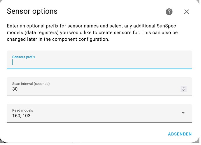

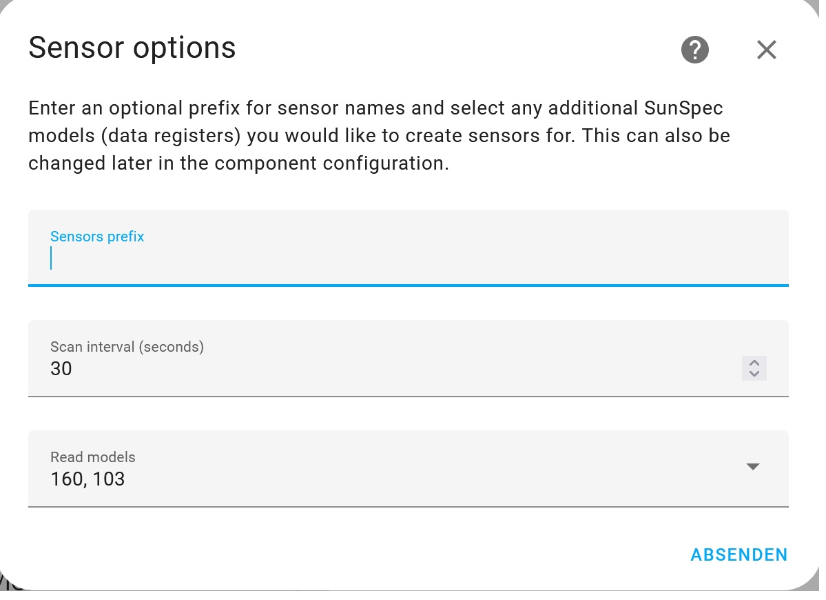

I tried to use SunSpec for the inverter. Iam not sure how to configure the integration?
After just activating all options I got 14 devices with 90 entities. Where do I see the current yield, daily yield etc.?
